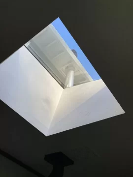

2. The chimney is DLV inside and class A outside with two 45 degree angles and about 20 foot stack.

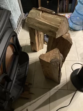

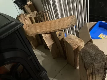

8. Im using more wood than I thought I would. About a full recycle bin a day. Or what you see here in large splits 20" long and pretty good size.

I like this stove but I am burning more wood than I thought. All the wood in the photos would be burned in one day if it was a cold day in the 30's. Seems like alot for a CAT stove. Ive seen some load this thing to the gills and get a 10 hr burn. Ive not experienced a good 6 hour burn yet however. Typically for me one large split and 2 medium splits and some kindling is like 4-5 hrs of good heat. More than that and I cant be in the room or im too afraid to go to bed since im actually scared of burning the place down.
