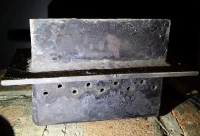

Here is mine...

I'm not to worried about it, but the circled area had me concerned a bit initially. And not really visible in that shot but on the side I am getting a pretty widespread solid buildup that I can't chip with the screwdriver. How do you clean it?

And here is the outside. Its pretty apparent the metal (or some kind of coating) is flaking off. This looked like raw steel to me prior, not painted or anything I could tell. It looked fine until after I cranked it up to 9 overnight the first time, then the next day when I cleaned a few large chunks came off the outside. Paper thin blackish wafer, that later crumbled sitting on the bricks.

The outside pictures certainly look like some sort of paint or coating coming off. Hard to say on the inside until it gets clean. So far I just use a gasket scraper but more experienced people than me suggest soaking in water to loosen it so i am sure that is great advice. I burn mine hot and high at least 1/2 the time so far for starting on 3 weeks and my pot scraper cleans to like new each time. Not literally but no wearing away of any of the burn pots metal structure. My air holes are all sharp and defined.

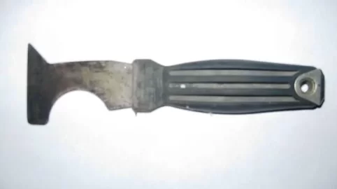

For me a Painters 5-in-1 tool seems to work the best.
It is stiffer than a putty knife and the pointy end gets into the hard to reach areas.
