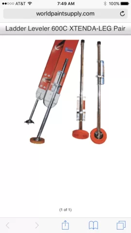

A single section of a 24' extension ladder with leg levelers and a removable ridge hook is probably my most useful tool. There's rarely a day that I don't use it at some point.
