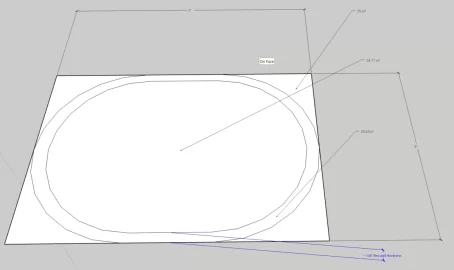

What is it about a 5x7 oval liner (35 sq inches) that won’t work with a 6 in (28 sq inches) draft stove?

There's nothing wrong with it in general, but the area is most commonly about 24 square inches in flex liner that size. By scaling use of the stove to known UL maximum ratings, you ensure that you don't exceed the draft speed or volume per square inch of a given pipe, as long as the manufacturer ratings don't limit you further. Draft speed and flow rates are not constants on wood burners anyway, and the variance of flow characteristics allowed by most stove manufacturers based on draft pressures is usually larger than the variance between 5x7 and 6" pipe. Once you further account for the variances introduced between high and low burn rates on stoves, the pipe size example in this case is trivial. We just have a lower safe maximum continuous burn, and as UL standards are safety standards, already have a margin of safety accounted for and are not truly "maximum maximums" near a point of failure.

It will work. Yes the volume is a bit higher but an oval won't flow quite as well as round so it will close to even out. It also depends upon the actual shape of that oval the volume may not be as high as 35
