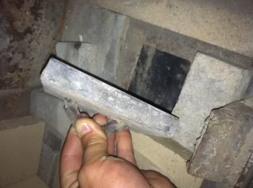

Pen I'm worried about the ash pan cover on this since I'm pretty sure it's home made just a flat peice of steel with a loop welded on it I'm going to just shovel the ash out Bc I don't want it to suck air down there and not shut it off so should I just put a fire brick over it and use that stove glue stuff and put it down to cover the hole. Think that would be better? Thx it don't set flat down over the hole now.

If it's a plug then furnace cement it in...if not maybe cement in in place?
Just put a piece of firebrick in its place. Ashes will fill in around it and seal it on the first burn. Easier to scoop ashes out without that loop in the way.
Reactions: fossil and Jdog
Ok thx brother Bart that sounds like the best to do then. So no need for the cement. Like I said I was going to shovel them out anyway.
