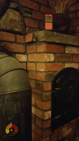

Everything I read said that if I do this Ill be fine. Out of curiosity I wanted to know what the flue gas temp was leaving the flue, so I purchased a "Thermo Pro- Remote Food Probe" (cool little device!) and monitored the temps from the top of the chimney for several nights. I mounted it in the center of the flue about 10" down from the top of the chimney flue using steel rebar as a support.

Here are a few better photos from "Google Photos" of the house lay out and chimney set up in the rear of the house.
