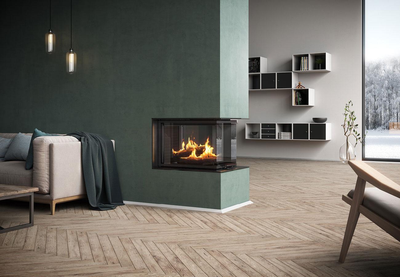

The units looks like this and are not made of masonry:
Could it really count as a masonry unit?

This came up a year or two ago. Superior makes one.
(broken link removed)
And there is the Rais Visio 3-1
Thank you begree! Unfortunately the Superior is discontinued, but I could perhaps get my hands on one? Is Superior considered a good brand? Can't imagine that unit is very efficient, but who knows.
The RAIS is from Denmark, which I suppose is the same problem as all the other European ones: they're generally not certified for use in North America. Unless these ones are???
I don't know if I'm missing something, but the stated firebox size for the Rais unit is 0.85 Cuft after converting from metric. That's a touch smaller than my Morso and seems impossible for a fireplace that size.
Contact Rais Canada and see what they say. Otherwise, maybe rethink the design and put one of their stoves on the end of the peninsula?
[Hearth.com] 15,000$ minimum for a u/peninsula shape wood fireplace. Am I missing something!?
As you are noting, peninsula wood-burning fireplaces are not in high demand. Gas units are easier to locate.
