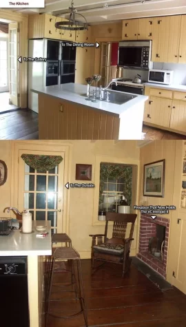

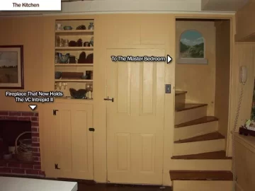

Kitchen
  • [Hearth.com] 1741 Farmhouse or: How I Learned to Stop Worrying and Love Wood Burning
Kitchen pt2

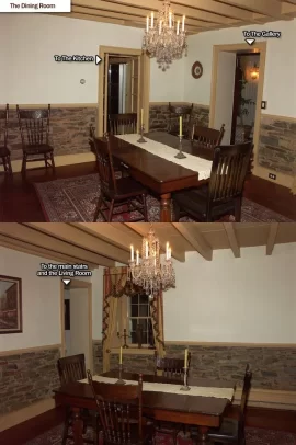

Dining Room

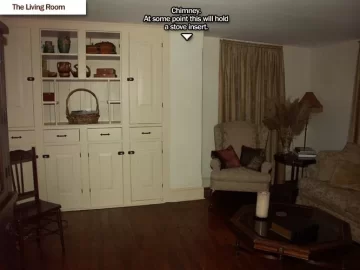

Living Room Pt1

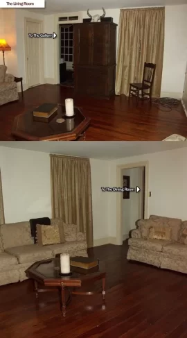

Living Room Pt2

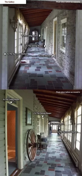

The Gallery

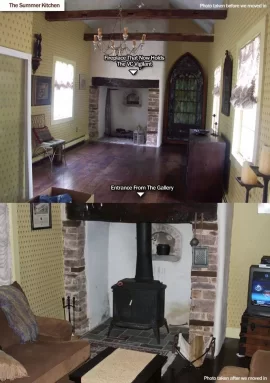

Summer Kitchen
Preused ufO brOKer said:
i got impression u had uninsulated exterior stone wALLS.
I do. The kitchen, dining room, master bedroom, and second bedroom all have exterior stone walls that can not be insulated.

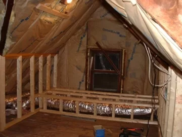

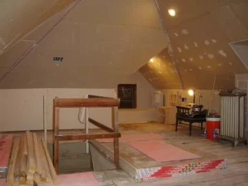

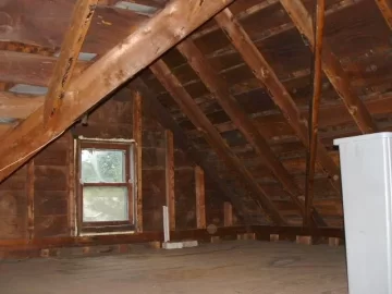

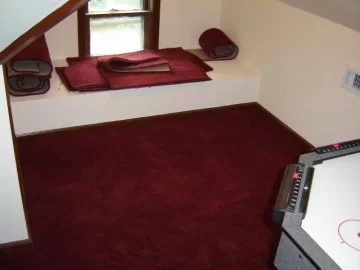

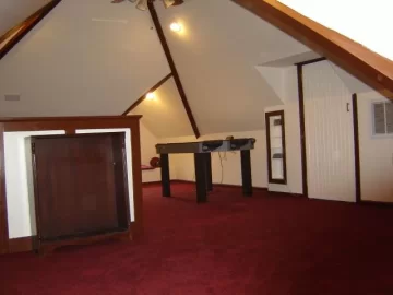

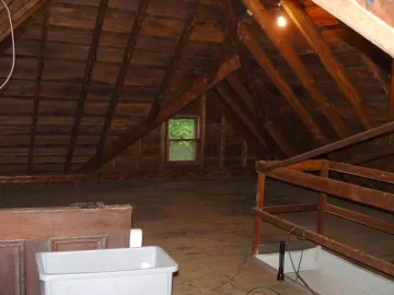

If you don't have attic insulation, then you definitely have a major heat-sink there. When I insulated our attic, it made an ENORMOUS difference. We have a 14' attic peak and I finished the attic space into a "bonus room" area, so it's all in the roof, not the floor. When we had a plaster ceiling collapse below it 2 years ago and I re-rocked our bedroom, I stuffed a foot of fiberglass into every box sill around the ceiling. But the floors are still uninsulated except for any remnant cellulose that drifted in from the blow-in years ago. I'm contemplating a lot of drilling and Great-Stuff'ing this summer to shore up the floor box sills. I might borrow a borescope from work to double-check my work :)
One note about using Great Stuff (expanding polyurethane foam) - do it in warm weather. If you try to squirt it into a cold box, you'll actually see it shrink instead of expand. It's useless to apply in the cold.
Edit: added photos of the progression thru the attic from as-rec'd, to insulated, framed, rocked, and then finished. Fine, I like to show off. :) Sue me.

Interesting that you insulated the roof/walls rather than the floor - I have the insulation available, but logistically with the amount of stuff in our attic I can't remove everything to insulate between the floors. Did the wall/roof insulation work well?
I do have insulation in the attic, just not nearly enough. Nice work on your attic! I have the same style roof as you do (minue the additional angles). I was thinking of adding insulation to the ceiling in the same way, except I won't be covering them with drywall/plaster. Will leaving the insullation exposed have any effect?
My anecdotal observations are as follows:
When we moved in, the whole attic was covered in tarpaper and sawdust insulation. In the winter it was in the 40's up there. Not enjoyable. And got lots of bats.
When we had the roof done, a part of that was to rip out not only the old original cedar layers, but also the tarpaper/sawdust mess as well. They re-decked the entire place in 1/2" fir CDX plywood, which sealed things up better than before, and it was in the 50's that winter. They added ridge and soffit venting, so there was deliberately more air motion than ever before. Still got lots of bats.
Then we insulated. R-19 everywhere (only 2x6 roof rafters) but I stuffed R-30c across the collar ties added in for the ceiling fan in the high peak. There's a pair of roof-mount vent hoods in that space as well at the top of the peak to assist in venting all that soffit-vent collection area. Added vapor-barrier plastic and it was 62ish that winter. Still got bats, which puzzled us until we finally found out where they were getting in.
Now w/ sheetrock, paint, carpet, furniture, etc - it stays 64ish up there all winter. So it's a negligible effect, but I think it added a little something to tighten the space up, especially the hard-to-reach back areas where I wasn't able to insulate well. The sheetrock cuts down on air movement. And bat movement. If you can really seal things up well, you'll notice it less. But it's tough w/ lots of angles/corners...

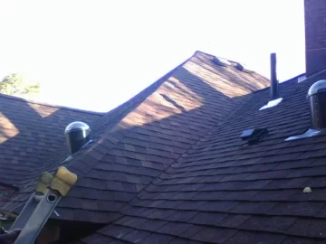

Where were they getting in?
Kinda tough to see in this pic, but there's a funky little hip in the lower left corner. That's where the main body of the roof (see the main peak w/ the roof-mount vents - those sit directly over the ceiling fan in the other pix) has the gable end w/ the chimney extending off it to the rear... The gable roofline sits a little lower, out of necessity - I think it was a last minute design change from the owner when it was built in 1885... Those little teeny deep-soffited hips were wide open up high and out of sight. A mesh excluder followed a few days later by a couple cans of Great Stuff fixed it.
Hearing bats crawling around in your walls (this was actually after we started sheetrocking) is pretty creepy. But it helped isolate where the problem was occurring. And a bat, in broad daylight, trapped in an aluminum gutter? NOT a pleasant sound.
BTW - If you have ANY wildlife problems, I highly recommend Don (last name escaping me...) who runs a little business called Animal Solutions out of Willimantic. He is absolutely, without fail, the most cost-effective and experienced individual you will ever meet for wildlife control issues. And he's seen it all, and knows how to fix it. For insects, we use Willington Pest Control. When I called Willington Pest about the bats, they recommended Don. I've never regretted the decision to call him. I had two other guys out originally and they wanted 10X what Don charged me to handle this problem.
