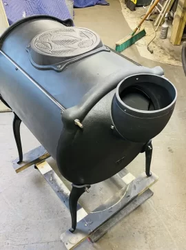

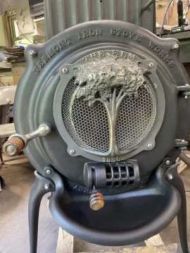

Finished restoring another of my 24in non cat Elms today . I love these , by far my favorite stove. But I may be bias because im from Vermont. Not sure yet if this one will stay in the collection or not yet...

It absolutely is! The outside glass is a 9” pyrex pie dish! There is inside glass as well, that is your standard ceramic fire glass.

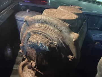

As far as condition, Ill attach a before(and a pic of the inside glass on the door), Ive gotten them pretty beat up before and rusty, and I sandblast them and replace anything that bad. Including I use the same machine shop Steve did, when he was building them, for barrels.
