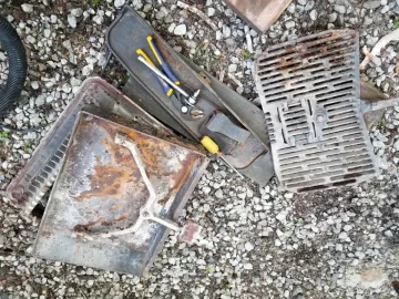

As far as the overall stove condition, it looks pretty good. See photos. It needs new glass and all new seals, but the bottom grate and grate stand are in good condition. The rear baffle (I guess that’s what it is) that mounts on the inside of the flue has a small crack (yellow circle in photo). Since its only on an interior component and not on the back panel of the stove itself, I’m hoping that’s not a huge issue and can be patched with some cement. The coal hopper is in decent shape, not sure if I’ll end up using it much, but I may try it at some point.
Both of the rear feet are broken. The foot pieces themselves are fine, but the threaded rod they attach to is bent at one location and broken on the other. I pulled out all the interior components and inspected them. Even after spraying some of the bolts in the rear with anti-seize lube, I still broke off two bolt heads and will have to drill out the rest of them. The outer panels of the stove look good. There’s some rust on the interior and a bit on the front over the door, but otherwise the outer surface looks good. After removing the rust, I’m thinking I’ll finish the outer surface with stove polish as opposed to stove paint. I’ll probably paint the interior and components with high temp paint.
