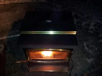

Here's the finished pics of the restore of the Avalon 900. I am burning it outside to get the paint smell out of it.
From this [Hearth.com] 1991 Avalon FS makeover...suggested tips welcome to this [Hearth.com] 1991 Avalon FS makeover...suggested tips welcome :cool: [Hearth.com] 1991 Avalon FS makeover...suggested tips welcome :cool:
