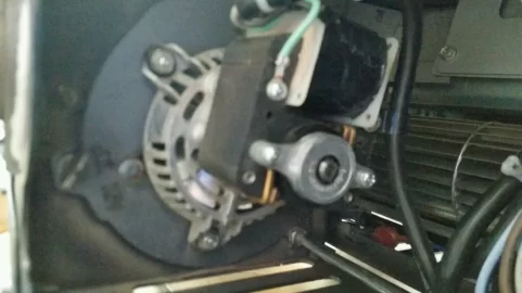

So... we have burned 1 ton since 10/15 - and I decided to do a good cleaning over this weekend. Never mind that trying to access our stove to say mildly very tight quarters since it's kitty corner and i have to lay on the floor to pull the back... anyways - I pulled the back to find the exhaust motor fan and looking for the 3 thumb bolts I was stopped in my tracks --- I found the 2 - i.e. 1 at 10 and 2nd at about 1, but the 3rd - no thumb bolt - what I saw was a nut with a long extention and a bolt head - see pic - am I supposed to take this as a thumb bolt? pic in the manual just showed an arrow. I was reluctant to loosen it so I didn't. Everything else looked really clean - found the fines box and that had some dust and about a palm full for 1/4" pellets... I will say however bad design - when you open the fines box - it falls on the intake fan below it --- next time i will cover that with a small rag something so mess is less. Also still having a issue with the fly as not getting into the pan and accumulated more toward the left of the stove than the right. Anyone else have an issue with this? It was just as deep at the ash in the pan. Thanks, all....

Ash gets everywhere , get yourself a cheap paint brush and just brush it down into the pan. I'm not familiar with the fan design, on my P61 there is a hatch inside the stove behind the ash pan that pulls out and the fan blade is right there. I brush that down too.
The long bolt would need to be loosen with the two thumb screws to get the exhaust motor out. It is a long bolt because you would not be able to get to it if it was a thumb screw.

Thanks, even with the wires - there is almost no play on getting this fan assembly out - I find that there is very little room to work with - Someone should re-write the manual to say that it's 2 thumb screws and a long bolt, along with making the ash pan span the whole width of the box....... along with a few other things I am noticing. "Get a pellet stove" you'll love it. I will say wood is messier but throw it in and let it burn... Pellets - rub it's belly and take it's temperature!! Hubby is away alot due to business so this feat is left to me.... and I'm on a learning curve.... Thanks, all. it's nice to know you can go somewhere and get the real answers. The dealer never went into any kind of detail with this stove and You've all been a big help!...

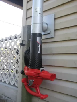

Yeah, you still want to do a cleaning - just finish it up with the LBT. You will be stunned by how much comes out even when you swear you could eat off the dang thing. Oh, and make the leaf blower has both the sucker and blower parts - don't want to be blowing into the pipe!

I take a brush and clean the outside pipe then hook up Mr Hurricane to the pipe.. always get a brown cloud zoom out...which I try not to do on a windy ass day.

It sounds like you are getting the hand of it really well. If I recall, I think the bolt is 3/8 or 7/16, using a socket wrench on it works for.
