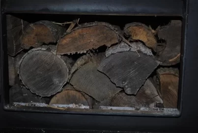

As much as you can, here is a picture of my Princess loaded up.
As for the smoke if it's not paint burning off it could be a draft related issue, is there a lot of smoke building up inside the stove when this happens or is all the smoke in the stove being pulled up the chimney?

Ya know I've never loaded North/South. I feel like I can fit longer splits in east/west and hypothetically a longer burn time, right? (But at the risk of wood hitting the glass)
The majority of the BK crowd here only burns them n/s from what I can see. I feel I get a better burn that way. More wood equals longer burn times and I can pack the stove better n/s.

I could see being able to pack it better because u don't have to reach to the back of the stove, but don't u have to make your splits shorter?
Yes they have to be cut shorter. I'm not sure I see how that matters though. A full stove is a full stove no matter if it's loaded e/w or n/s, I find it easier to pack a hot stove full loading it n/s. I tried loading a hot stove e/w one time and decided I'd never do it again. ;lol
The princess firebox is nearly square, it is a couple inches wider than deep. When trying to fill any firebox I believe it is silly to load sideways. Stuff rolls out, you can't see that you've filled every gap, and I really do believe that with the cigar burn we're getting on these BKs the air needs to come in the ends as it does with a N/S loading.
