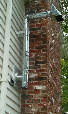

Hey guys i ordered mine from amazon for 23.00 free shipping ! I love it great tool ! I bought the kit came with a bunch of pieces!
i remove the bottom cap and Tap on the pipe to get out any heavy ash then run the first length up the flue then screw on second piece while its up the pipe and the brush ends up coming out of the hood now its minty fresh!!
Then i flipped over my toro ultra leaf blower and placed the suction portion right up to bottom no gaskets and blew the rest into air
