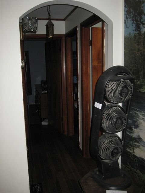

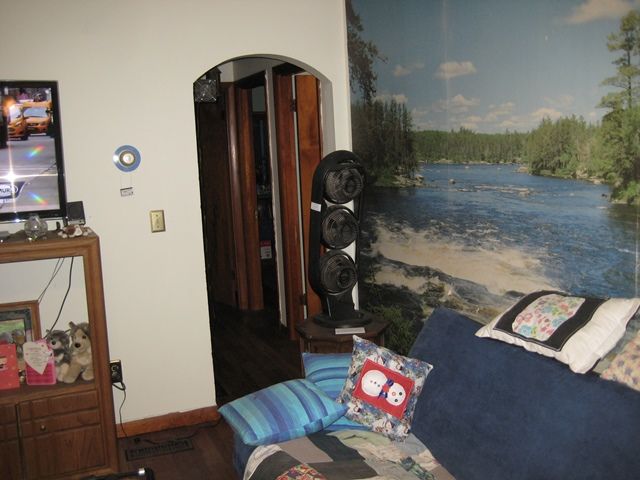

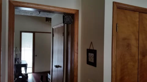

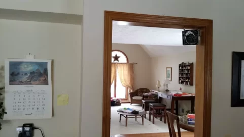

pell it beat me to it ... fan blowing cold floor air towards the stove. It doesn't have to be gale force winds either;lol In our case, we put in-line fans into ducting from old system to draw heat from other rooms and push out vents in stove room.

I run my stove on high and move the air with two small fans in the corners of my two doorways leading to the rest of the house. It is going to be different with every set up though. When my fans are running it warms up the front of the house by 7-10 degrees. When they are off the family room and kitchen are real warm and rest of house is cold. Here are some picks of my situation. I swear by these little fans. They are very quiet and move quite a bit of air.

Tried it the way you are doing it and always seemed to have cold air blowing on us and way to loud. These fans you can't tell they running and we don't feel a draft at all.
