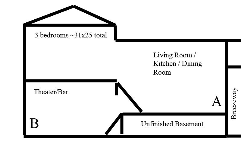

Here is a little diagram of where i can put it. Location A is where i'm thinking but you all think B would be able to heat the whole thing then great. Planning on using a few fans to push the hotter air up the steps to the bedrooms and also use a few ceramic space heaters in the bedrooms and theater.

my kneejerk would be B for ease of install (don't have to worry about roof leakage).....if you go A, the only good way to do it is thru the roof....gonna be spendy then......if you have a big opening from the bar to the living room, just might work........don't use the fans until you know you need you have to......I heat 2 floor with a P61...no fans....I'll give you my stove is bigger, but it also doesn't run full-out either

I could put it in the bar area where that table where 2 stools are located. My only issue there will be that might cramp the bar. i'm assuming ~40" will be taken up by the stove and hearth/pad depth wise, sound about right?

The hot air would have to then travel out this direction to the next level (lr/dr/kitchen)
