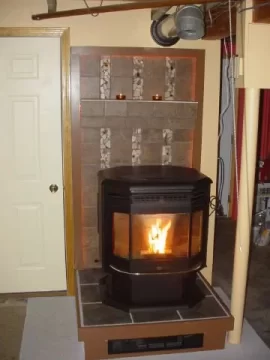

Here's a shot of the new bundle of joy -
[Hearth.com] 1st time poster with a new stove and a question too!

1st off. Welcome to the Forum. Wonderful site they have here... You read enough already to know. WE LOVE PICS... Very 1st Post and your bringing the Pics, well done.
Yes on the Surge Protector. As others stated. You will need a LARGE UPS to fit the bill. Beautiful install. Depending on your total square footage, the Castile or Advance may have done the job. My buddy has a Smaller Breckwell and he has Cathedral ceilings throughout his entire home. More than 2,000 sq ft.... Either way, you got a BIG stove, It looks fantastic, and you have came to the right place for Info. Congrats, she is a beauty....

Very nice install. I like your tile and mantle work!

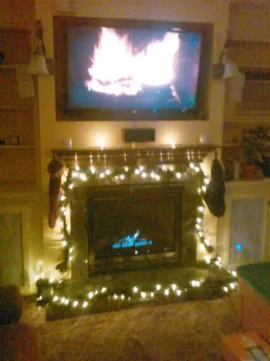

Now it is $3.52 per gallon. So I do not use it as much. Since I got the Heat N Glo, I installed a wood pellet stove in the basement to heat the whole house!
  • [Hearth.com] 1st time poster with a new stove and a question too!
