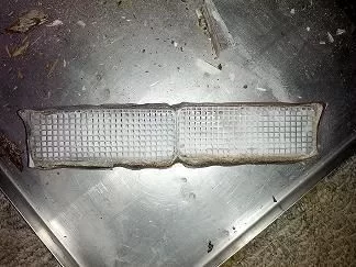

Back in October I purchased a new catalyst, refractory, gasket kit, and secondary air probe for my VC Encore 2190 through Hechlers online. After installing the new parts, and making sure everything else was in good shape, it was operating like an entirely different stove.
After spending over $500 for all these parts, my wife and I have been VERY careful with the stove temps. While we don't have a cat probe, we have a surface thermometer on both the griddle, and the side of the stove-back, where the hot gasses leave the refractory. We NEVER allow the griddle temps to get over 650, and NEVER let the temp at the stove back to get over 700 (I have been told that 600 is ideal on the back thermometer).

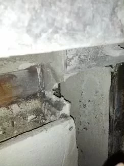

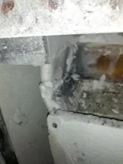

A few weeks ago I noticed the catalyst temps weren't staying up when we turned down the primary air like they had been. I thought the catalyst might have some ash blockage, so I let the stove die down overnight and went to clean it the next morning. What I found was pretty disturbing given the money we just spent a couple months ago, and the care we have taken to keep everything in good shape.
The can on the new catalyst had warped so badly on the corners that it broke the sides out of the new refractory! [Hearth.com] 2.5mo old catalyst and refractory...this is bad.[Hearth.com] 2.5mo old catalyst and refractory...this is bad.[Hearth.com] 2.5mo old catalyst and refractory...this is bad.
What's worse? I just called Hechlers and they told me that there is no warranty for can warpage. He recommended that I cut the can off the catalyst and use stove cement to patch the refractory. :O
When I reminded the guy that these parts are only a couple months old and this SHOULD NOT have happened, he gave me the number for Applied Ceramics (who they buy catalysts from) and told me that they handle the warranties on their catalysts directly. Unfortunately all I got was a voicemail, so I'll just have to wait and see how this comes out.
Has anyone else had this issue with a catalyst this new? I am well aware that stainless (which I believe the can was made of) is prone to warpage, as I run a shop which does a great deal of work with #304 stainless), but to me, this is very much a flawed can design if it warps this much in a couple months of proper temperature range woodburning.
The can on the original catalyst from the mid-90's (the previous owner of the stove never changed it), was bowed, but nothing like this.
Thoughts? Advice?

Bummer. It sounds like you've done everything right. I'm surprised at the casual response from the stove shop. Was this from the owner?
Unfortunately it sounds like a repair with some refractory cement and replacing the defective cat with a non-stainless one is the only recourse to get you heating again without delay. I would carefully insert some "pins" into that right side to reinforce the refractory repair.
I'm not sure if it was the owner or not...sounded like the same guy I talked to when I called to check on my order way back when.
The cat itself wasn't stainless...ceramic with a stainless (I believe) can, same style as OE...and might be OE for all I know.

I doubt you'll have much luck cementing back together the refractory. Once the refractory surface has been exposed to fire it doesn't seem to want to take cement anymore. And general-purpose stove cement isn't up to the job either - you really need proper (and expensive) refractory cement.
We had a cat, one of the SS ones, warp and start falling apart in 3 months. The manufacturer replaced it. You may have better luck getting a new cat under warrantee from the cat manufacturer than a new refractory box from VC, as the cat manufacturers are fairly philosophical about returns. The long skinny VC cats seem especially vulnerable to warping, compared to the round ones, and to a lot of damage when they do since the refractory is so fragile. Dumb design, if VC had thought of sandwiching the cat between iron plates like the Woodstock does we'd still be happily burning our Encore.
It only takes one or two episodes of overfiring to start the destruction of the cat and refractory box. After we trashed the first refractory package in our Encore we got a lot more careful about how we ran the stove, but it didn't seem to do any good - the rebuild only lasted half the time the original one did., and the next rebuild even less. We finally gave up on the stove rather than put more money in to it. Ssad to throw away 500 lbs of gorgeous cast iron for the want of a viciously overpriced 2 lb. refractory box.
