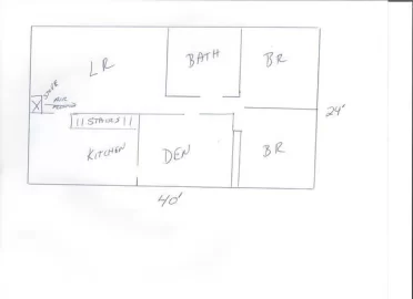

im on oil heat out here at my new place and the lay out of the house means I can install a pellet stove in my living room which with a couple fans can push the heat right down the hall that leads to the rest of the house.
So this is what I am looking for (have wood stove experience not for my house no thank you)
A blower
Thermostat
Something that can hold at least one bag
Easy to clean
Easy to work with
I know everyone has their fave stoves but if you could list pros and cons of those you have personal experience with that'd be great
Also, what am I looking for installations Costs? I'll need it installed
Cost of the stove?
Harman's don't technically have thermostats - they have room probes, but a thermostat can easily be hooked up (my P43 is currently shutting down after the thermostat told it the house is warm enough). The hoppers are large enough to hold at least one bag (and extensions can be bought to bring that up - both my stoves can hold 2.5-3 bags). Easy to clean and the ash pans are large enough that can go several weeks between emptying the ash pan. Please keep in mind I am only experienced with the P-series, so if you are looking at inserts, that could be different.
As for install, if you can possibly set up the stove so it already blows directly down the hall, I think you will be happier and use less (or no) additional fans. This is my currant configuration, and I don't have to use supplemental fans at all to keep the bedrooms 40' away warm.

I previously had a St. Croix Hastings that was a true corner install in that same spot (necessary for clearance reasons) so the air stream was aimed kitty-corner, and I had several fans set up to push the air down the hall. Very noisy and the bedrooms did not stay nearly as warm. Just something to think about.
