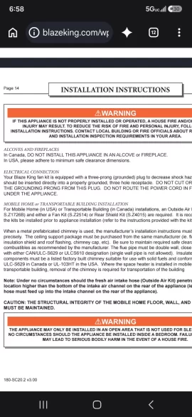

The entire install should be redone. Your stove can not be installed in an alcove. But yes 10k is high.

In the US it can (when clearances are met, and it's not clear to me they are - if e.g. wood studs are in the wall).
The OP is in NY
Reactions: begreen and bholler
The OP is in NY
Oops read it wrong. Thanks
