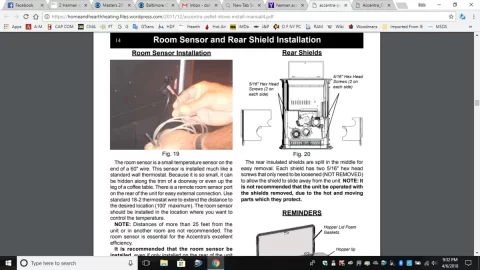

1. How long does the combustion fan run after shutdown? What is the trigger to turn off?
2. Where does rooms sensor connect? I see 2 small blue wires going directly to control panel. Could those be it?
  • [Hearth.com] 2 Harman Accentra Insert Questions
The combustion blower runs until the ESP cools off to... I think like 100deg? I should know as many times as I’ve had to wait on one to shut down, but I’m blanking. Usually about an hour. It will run indefinitely if the vacuum switch isn’t staying closed from a leak or clog somewhere. The room sensor goes to the blue wires.
90 sounds right. I know if it’s vented straight out or you don’t have AC it can come on when the stove is off if it’s a really hot day.
