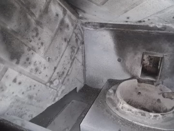

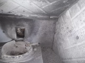

Yes went through stove and cleaned it. White ash but I haven't had any ash in the fire box. That's why I wonder if to much draft. My castile insert has to be cleaned once a week because of ash. The blowers are working fine. I made the back baffle and plan on purchasing a new one spring time,but made it as close to the old one that was broke in half. Here are some pictures. This was very bad when I got it, so I dont know if its missing anything along the exhaust path. I have put gasket material between the gaps of the baffles to see if that would help.
  • [Hearth.com] 2004 mt vernon  quadrafire

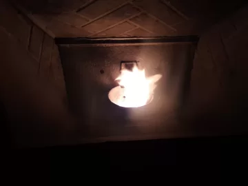

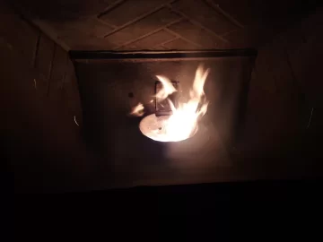

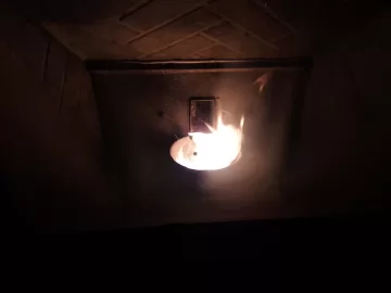

Here are some pics of it running
Once it warms up the flame is about 4 inches out of pot and not lazy at all. Just dont know why its blowing warm air and pipe to chimney is hot

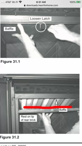

Did you put insulation behind the upper baffle?

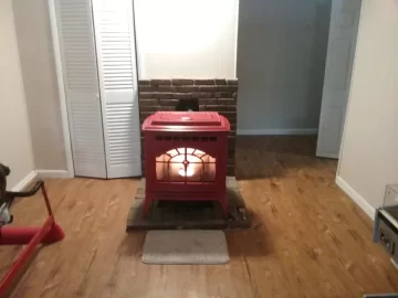

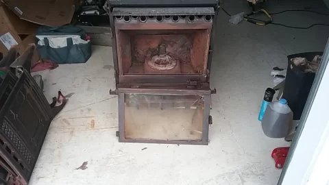

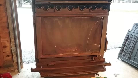

So the heat needs to move between the rear baffle an upper baffle. I thought it run through the exhaust port. I will try that . Thank you. Here are pictures of the b4 and after. Pick it up for 150. I really like this stove.
