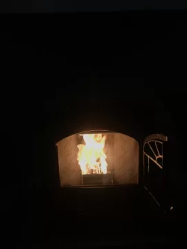

Hi, I’m new to pellet stoves. I bought this used and saw it working perfectly before I bought it. We cleaned it and got the damper unstuck and now it’s been one thing after another. It is burning very hot with a very high flame even on lowest setting. We’ve tried adjusting the damper and feed rate and it helped for a short time today then the flames got crazy again. I will include a video of what it’s doing. Appreciate any help I can get!

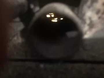

Sorry! I can’t get a video to load! But I was wondering as to the picture that did load, should I be able to see daylight through that?

It would if you could tell us what the picture is and where are you taking the picture from .

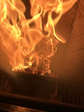

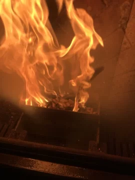

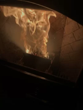

Ok, so I have gone through the whole process, getting very little change from damper adjustment or auger trim ( waiting about 15 min after every adjustment) I’ve included a few pics, not sure if they will be of any use but it’s what the flame looks like most all of the time. The pot also looks really full compared to how it was when we first got it.

Is the door open ? or is that just the decoration ?
What is the heat setting ?
how long had the stove been running ?
had the heat lite turned solid ?
this means it has reached operating temp. and you can
now adjust the temp output ?
does the auger cycle or just keep running ?
It’s just the decorative doors that are open. Heat setting is low. Stove was running little oer an hour 1/2 before I got nervous. It will turn solid and I can turn it from high to low. But the auger feeds the same no matter the setting, it’s using pellets fast and only slowed when it was nearly out of pellets. Thanks for your reply!

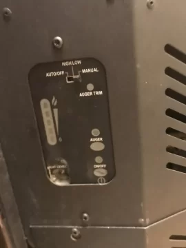

Does the ON/Off lite turn solid (not flashing)after approx 15 Min ?
Which board is in your stove see pictures in manual ?
Is the mode switch in manual?

If you put the stove in the Hi/Lo setting, does the fire go down after start up?
Also, that Heat Level button looks pretty beat up (Enviros are known for this). When you press that button, does the Heat level move up and down? I am thinking that button is the issue, so running the stove in Hi/Lo should override the manual setting and turn the stove down once the start up process is done. It is just a test to narrow the issue down.
For this to work must have a thermostat
If he crossed the 2 burnt wires this may cause the problem he has
Right.... Also, if there is no thermostat connected to the stove, the jumper wire between the thermostat connection terminals has to be removed. This makes the stove believe the thermostat is not calling for heat.
