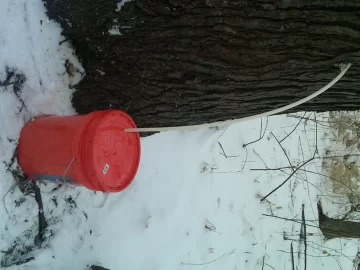

This is my first year doing it. I have 20 taps in 10 trees all right around 20"DBH with tubing into 5gal buckets.
I did my first boil this weekend and ended up with a pint of syrup. I had far from great weather as far a sap production goes (too cold all week), so I wasn't expecting much. It was more of a learning boil than anything. I should have had a quart finished product, but it got too cold in the filter and I was half popped so filters and half of my frozen syrup went into the wash bucket.

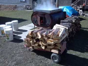

Here are a cpl pics of my first attempt at a evaporator. It worked way better than I expected. the cinderblock chimney have me a place to dampen it down when needed and almost force the heat back towards the front.
The cast iron pan prewarmer was key as to not lose the boil. Wood used was a mix of beech and sugar maple and I went thru about 1/4 of a face cord in 6.5 hrs. Good thing I hauled about 1.5 cords out while it was boiling because at this rate, I'm going to burn my camping stash up REAL quick!

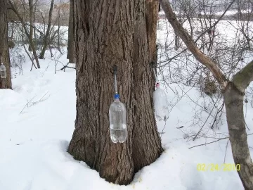

Next year, for certain, I'll be going all-out. Here's a couple pics from year's past of our setups, and how they progressed.....

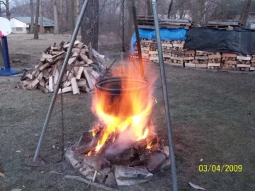

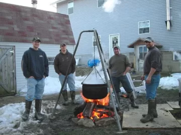

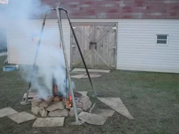

2007 and 2008 were my first years.....I built the trammel and tripod out of rigid conduit and a chain.....worked like a charm but not very efficient...did a LOT of babysitting this way because I had to keep adding sap and wood.....constantly...

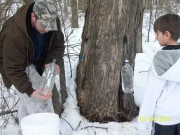

Me and my 'crew' out getting sap....

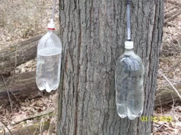

2010 pics, getting sap, cooking with the big kettle and my addition of the barrel stove I made (and it worked great, too). Found another Speed Queen washer tub on ebay and built a second kettle.....cooked 40 gallons at a time this way...

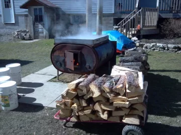

2011 I built the big evaporator......55 gallons at a time and it really gets the job done....
Pics below are of last year, didn't do so hot last year (should've ended up with 50-60 gallons of syrup, ended up with around 20 because it went from winter to summer in a matter of a week or two....). These are all the pics I have on this computer, I have literally hundreds more pics and videos on the other PC upstairs.....there are some videos in my older posts of the evaporator....

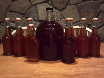

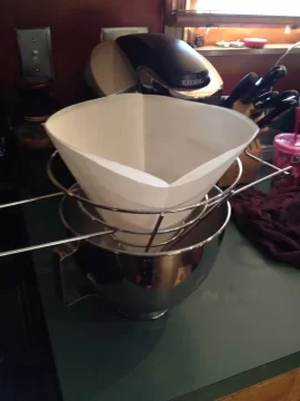

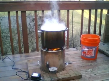

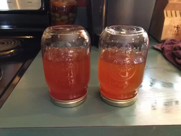

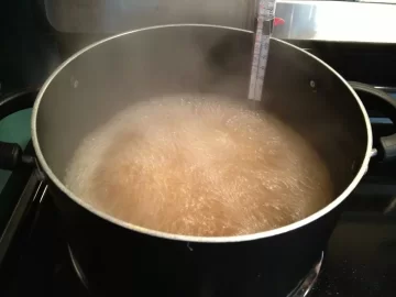

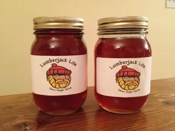

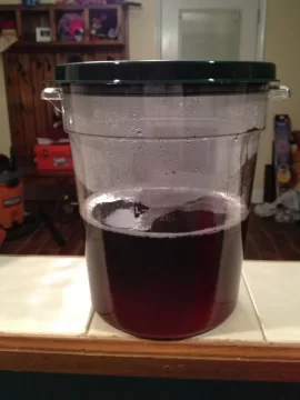

Just finished boiling my 2nd batch this morning. My first batch (22 gallons of Silver Maple Sap) yielded a little under 2 quarts which I bottled in 3 mason jars. They are the first few pics. I kept one and gave the other two to family. My second batch (12 gallons) yielded a little under a quart or 2 mason jars 3/4 full. My second run looks "lighter" than my first. I want to get a syrup hydrometer for next season so that I can accurately produce syrup at the 66% mark. I also want to purchase a larger evaporating pan to expedite the process. This was my first time experimenting with making maple syrup. Like Scotty, I also had to do a lot of babysitting during the outside boiling process. Just like others have said, man do you go through a lot of wood. Anyhow, the temps do not look good for sugar'n this week. I wonder if my season is over? If so, I'm okay with it. I had fun. Anyhow, some pics of the process and the final product.
[Hearth.com] 2013 Maple Syrup thread[Hearth.com] 2013 Maple Syrup thread[Hearth.com] 2013 Maple Syrup thread[Hearth.com] 2013 Maple Syrup thread[Hearth.com] 2013 Maple Syrup thread[Hearth.com] 2013 Maple Syrup thread[Hearth.com] 2013 Maple Syrup thread[Hearth.com] 2013 Maple Syrup thread
View attachment 96286View attachment 96287View attachment 96288View attachment 96289View attachment 96290View attachment 96291View attachment 96292View attachment 96293
Looks good, Stax! Even have your own label! Keep sappin' , and taste-test the sap from tree to tree. If the temps stay like they are calling for, the buds will swell and the sap will take on a 'woody' taste.....that's when you know it's time to pull the taps.
