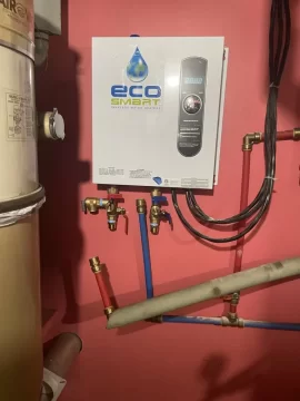

This Eco Smart 27 KW electric DHW panel requires 3 - 40 breakers in the electric panel. It has 3 heating elements that we’re getting dirty with some scale build up. Therefore the hot water did not seem to be as piping hot as it should. Therefore I switched to the oil boiler for DHW with the 40 gallon superstore tank while acquiring some parts and knowledge to possible clean this thing! LOL

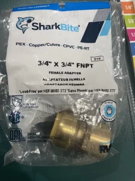

Just to make it a little quicker and easier, I got 2 - 3/4 shark bite Pex connectors instead of reusing the Pex connectors there after cutting the pex piping shorter to include the valves.

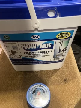

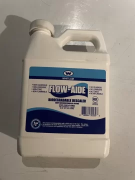

All this work went like clock work with a channel lock pliers and an adjustable crescent wrench and when it was time to run the cleaner it was super easy! The Whitman Flow Aid System Descaler kit did the trick. The cleaner is non toxic and works 20x better than vinegar. Therefore the cleaner only has to be run through the panel for 30 mins. :)
Amazon product ASIN B083ZFJD4PJust hook up the hoses to the valves and pump and put in a gallon of water with the quart of cleaner in the bucket that comes with this kit. Run the cleaner for 1/2 hour and then turn on the cold water to flush the rest of the cleaner out. Remove the hoses and turn the valves back to normal operation and bingo it is done!
Good DHW On Demand for another year!

The scale that is cleaned off is usually white calcium carbonate so you may not see real dirty water when done. You will notice hotter water and maybe better water pressure too.
So far after a day the water is nice and hot!

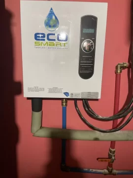

Pic 01 - Eco Smart Before Isolation Valves Installation

Pic 03 - Flow Aid System Descaler Kit & Blue Monster Teflon Tape

Pic 07 - 3/4" Pex Shark Bite Connectors to 3/4" threaded pipe

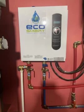

Pic 09 - Valve kit all connected with safety release valve directed into bucket
Pic 10 - Valve kit all connected close up
Pic 11 - Valve Kit with cleaning hoses connected

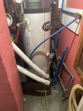

On a electric tank, the whole tank must be drained to get the chips out and the elements must be removed and scrubbed to get the scale off. If not done on a regular basis the elements may need to be replaced.
I also have a SuperStor tank.

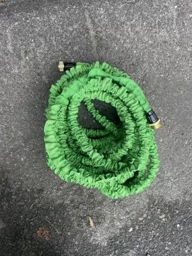

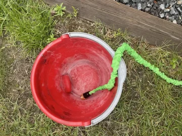

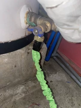

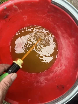

I just did the nominal tank maintenance by just opening the bottom drain and draining the bottom sludge into a bucket outside. The new expandable hose is perfect for this job. There was some black bits and rusty water! See pics below.
An annual 1/2 hour On Demand panel flush & the 15 minute tank flush each year should really prolong the life of these utilities. :)
