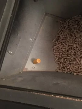

Well,i have never seen one in an Accentra,perhaps take a picture of inside the hopper where it mounts?If you need to temporarily run stove,you could bypass the vac. switch with a jumper wire,but always be at home when it is running,for safety.
Uggghhhh! It seems this is something recently added to the Accentra-2 since mine does not have one. My next thought is to call the local Harman dealer if there is one near you. You might also try calling Harman directly since you may be hundreds of miles from a dealer.

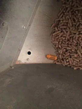

Here is what it look like in the hopper. Then the hole after I unscrewed it. The backer and hose fell down underneath the hopper and there is no way to get a hand in there to re install. Lame

Well that sucks.BTW to clean that,you unhook the hose off the switch and blow back through.Well,if I was doing this-the plate above comes off,is just a plate and gasket.I would run a lightweight mechanics wire down the round hole to where I could get to it.Screw a sheet metal screw into the fitting,gently,not real tight.Wrap wire around this screw,pull up into place.Go through the plate access and hold into place,however possible,bent pliers,bent screwdriver,magic fingers,etc,remove wire and screw,and screw filter back in.BTW,what is the date stamped on the back of your stove?
Thanks, I was afraid of that. What a pain. It is stamped 06/2009 although purchased new in ‘16.
Yep,they sold you an old model.Take a look at the vacuum switch,see if by chance there is a T fitting and 2 hoses.If not,I think you are going to have to reinstall the part.

I'd try using a coat hangar and fishing it down the hole to attach the hose and pull it back thru. That is if you can find where the hose dropped into the back of the stove.

Hello, I just wanted to let everyone who finds there way here know that I had the same problem and solved it by:
  1. Taking off both rear panels
  2. Finding the hose below with the threaded end
  3. Holding the hose by reaching into the area that houses the control box, nearest to where the muffler attaches
  4. The opening is too small to reach a hand through, but I just held onto the hose as close to the opening as possible
  5. Working it until the thread shows through the hole in the hopper
  6. Hold the thread in position and turning the muffler until the thread caught
I hope that works for you if you're having the same issue!
