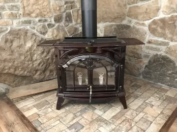

Woodstock IS owner here checking in...
Just curious what you guys got going on. My friends parents have an older EPA Quadra fire stove. I really liked that stove. They just sold their house!
I am selling my house to here real soon. I'll most likely be leaving the quad behind.

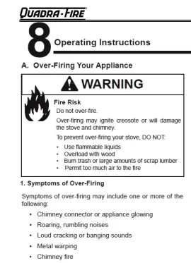

Believe me, I don't want to start that thread either :-) At least on my car, I have a factory supplied tachometer with a well defined redline and the computer will shut off fuel before any sudden damage happens. On the Quadra I have this:
[Hearth.com] 2017 Quadra-Fire Performance Thread
That's analogous to my car owner's manual saying "if the pistons hit the valves and the connecting rods snap, you are over revving the engine".
I've been doing a lot of reading on the web and here on hearth.com, and 900+ degrees (when the stove begins to glow) is universally considered a bad thing. Below that temperature, opinions are mixed.
Here's a post stating that Quadra tech support says 700 is about the maximum:
https://www.hearth.com/talk/threads/quadra-fire-5700-stove-temp.59070/#post-737009
Here's another post that claims a Quadra engineer said "you can't do to that stove what we do here in the factory to cause them to fail" https://www.hearth.com/talk/threads/max-operating-temp-for-quadrafire-4300.26041/#post-349439
Let me repeat that I really don't want to damage this stove, but on the other hand it seems silly to turn on the propane furnace if I could just run the stove a little hotter instead. Heat output goes up dramatically with small increases in temperature, so a 750 degree stove puts out a lot more heat than a 700 degree stove.
I think we're in complete agreement that uncontrolled burns are a bad thing. We do seem to disagree by 50-100 degrees about what stove top temperature we're comfortable with.

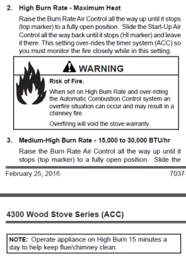

"Cabin" is a bit of a stretch. It is a 900 sq ft A-frame with about a 20' high peak. The furnace has been guzzling about 5 gallons of propane a day to maintain 50 degrees. At 91,000 BTU/Gallon that's 455,000 BTU/day, or almost 19,000 BTU/hour. Some of that is lost to the basement, so let's say I need 15,000 BTU/hour just to maintain 50 degrees.
According to the online manual, the way I was operating the stove is considered a medium-high burn and produces 15,000-30,000 BTU/hour:
So it looks like I should have plenty of heat to maintain temperature, but not a lot of extra to raise the temperature. The high burn rate is thus very enticing, but the warning is a bit scary. The note recommending 15 minutes a day on high is the cherry on top. I basically read it as "please live dangerously 15 minutes a day for your safety".
Burning hot like that will clean some creosote out of the stove pipe, but it's no substitute for an annual sweep.

Oh how I would love to buy those drying racks on that Quad!!!!
