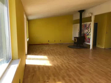

I haven't been on this forum for quite some time but decided to come back because my son is about to purchase a small fixer upper home on the Oregon coast. It has a completely rusted out stove of some sort. Not sure what it is but he says it looks pretty bad. So he was asking me for a recommendation and I remembered that when I used to hang out here the Home Depot stoves were pretty popular when it came to "best bang for your buck". As I recall, they were priced at something like $899 but then would go on sale every once in a while for $699 or something like that. So I took a look at Home Depot and see they have the Ashley Hearth Products which look similar to the ones that used to get recommended here, although they are a little more expensive. So, is this stove still get high marks around here? Is there something else you would recommend over it. My son is 26, a wild land fire fighter and off-season arborist. He and his wife are just getting started and this will be their first house. They are on a tight budget and will be using their entire savings on the down payment so something reliable and affordable is what they need. All suggestions and recommendations welcome! I'm attaching a photo of the house with the current stove for reference. And the home is about 1200 sq. ft.

May be worth a few close up shots of the current stove to get it identified. Both detailed exterior and interior pics. On the off chance a bit of elbow grease can make it usable.
Thanks. I wondered about that too but my son said it looked completely rusted out, including the chimney.
