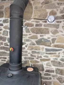

I actually keep a manometer (magnehelic type) mounted on the wall behind my stove, and plumbed into my 30 foot tall pipe. This way, I can always see what it is doing. Measurement is only valid at high setting, vacuum will always increase as you close down the inlet. In any case, BK spec's 0.06" WC maximum, and my 30 foot pipe was pulling over 0.20" WC, before I added the key damper. Unfortunately, I was running a steelcat before I added the damper, so I don't have any good data for you on what high draft will do to a ceramic cat, but I'd bet @BKVP does.

Over this summer I installed a new key damper that should help get my overdrafting issues under control. While I was doing that I replaced the interior single-wall piping with double-wall. It's kind of weird to be working on a wood stove when it's ~100 degrees outside. ;lol
