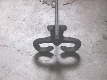

Take that cheapo fireplace tool set sitting doing nothing and take the end off of the poker. Screw it into the thing that holds all the tools together and, bingo, ash rake.
[Hearth.com] 24/7
That's awesome Bart!
It does two things, gives you an ash rake and takes that poker away from you that you keep smacking the baffle with. Wanna move splits, long handled tongs are cheap at Lowes in season.
