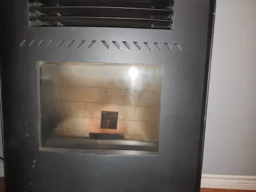

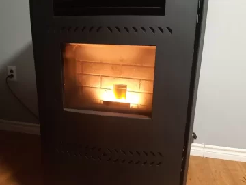

Yes I removed the thermostat and not getting a good burn now ..I didnt address the problems before because I didnt know that much about pellet stoves until I started asking around and finding out more about them ...as far as addressing the company I figured they must know the product they are putting out so what's the chances of them doing something about it ..as far as the air leaks it like fixing a pipe stop one leak and another leak shows up ..I send you a pick off the burn on 3 setting
Its alot brighter in the picture and no flame ..I have been fooling around with the setting ..first the feed and then the air ...then air and feed ...no good ..so I put it back to reset ..thanks

Have you taken it apart and cleaned the pathes inside the stove and exhaust blower chamber, vent pipe, burn pot?
When you raise the heat level does it feed change or feed more often? What are the bottom 3 buttons set at?

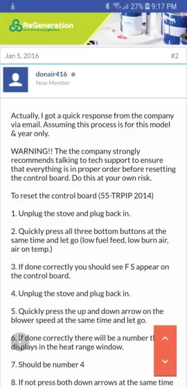

All around the 7 second mark .. I reset it and all are at 1 1 1 I tried ever different level and setting and no different except a lazy flame or to much air ..not that I dont get a flame but more heaters then flame ..switch it to this article I read and it was worst

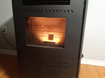

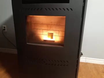

Put the bottom 3 to 5-4-1 and heat range at 2 and fan at 5 and see if that gives you a better fire. It may take 5 min for the settings to make a difference

K will try ..I dont understand why we would have conflicting info on this stove from the company .. when I reset it , it should reset to the default that the company program the board for ..this other article is a different default then the control board has..why would the company do this.?? ..I'll get back to you thanks
Most of the differences are from software upgrades or changes they make. The pdvc i had defaulted to mode A instead of D.

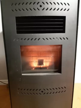

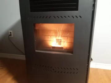

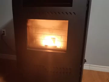

A little better but not constant...

Can you tell me why there are holes behind the firebrick ...there are 5 3/16 holes in the front plate of the heat exchanger..thanks

Thank you sir that's what I think 2 but any help or info is great knowledge..Ssyko has been a great help as you know it can be frustration..Ssyko if you are reading this I went to 6 4 1 ...give you a shout in about 5 mins
You could try both and see which gives you the best heat. Usually the bottom 3 settings only affect the heat settings 1&2. I don't know why the holes are there. I don't have the 25-ip I'm just trying to help get you burning good.
