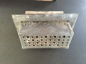

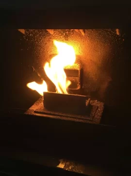

Look at the pictures of the fire and the front left corner of the burn pot. Notice how the ash is blown away from that one spot? It's leaking a good bit of air there, and it's never going to run clean while it's doing that.
I noticed this after you pointed it out, the burn pot seems to sit flush when cold though as you can see in the picture below. Is it possible the ash build up below the pot pushed it up?

If the ash pan still isn't sealing right you're going to continue to have problems. You've gotta get 100% of that air to pull through the burn pot area - if it can get it from anywhere else (ash pan, door gaskets, hopper, etc) it'll never perform right, it just doesn't have any reserve combustion blower capacity than is necessary with a perfectly sealed stove. I'm surprised even with the gasket that it doesn't seal right - I'd get out a straight edge and check the pan and the stove to make sure everything is straight - it should be sealing if it is.
It is critical that the burn pot sit flat and not rock when in its cradle any air going out around the edges is less air through the pellet pile.
The area under the burn pot must be cleared of ash.
There must not be any gap around the flange of the burn pot and the burn pot for the same reason.
When cold the burn pot sits flat with no rocking in the cradle and the flange is flat. While cleaning I did notice a little chipping along the back wall (included picture, not sure if its related)
