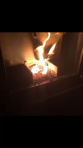

OK,
FWIW , just shut the stove down as it had set the smoke detector off in the room from running too hot again, it had been running for 1 hour and 40 minutes , the top of the stove over the door was at 627 degrees according to my I/R gun , this was on heat range 2, Blower speed 7 . LFF was at 1 , LFA was at 5 . Picture attached was a quick open the door shot , as you can see the auger(s) had overloaded the burn pot area to a point that it overfired the stove , wild sooty flame , etc....
I would not guess at this low of a setting that the stove should burn this hot ?? No ? That the auger should not keep piling pellets into the pot and overfuel it ?
This does not happen from the start , it takes a while to go haywire like the picture , it was burning fine for the first hour or so , the last 20 minutes +/- you could see the burn pot loading up like this .
Thanks
TOM

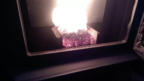

[Hearth.com] 25 PDV high burn issues Just snapped a quick shot of mine this is after 4 hours running on heat range 5 your def getting too much fuel... How is the flame? Is is slow or does it rip like crazy?

View attachment 146453 Just snapped a quick shot of mine this is after 4 hours running on heat range 5 your def getting too much fuel... How is the flame? Is is slow or does it rip like crazy?
I wish mine would look like that after 4 hours , I cant even use it for 4 hours as it will load up like the picture I posted.
Not a rip roaring flame , but not lazy either . I stopped the exhaust blower while burning and there is significant difference , definitely airflow there , is there enough ?? I dunno .....

Ouch, Tom, looking at the picture you took of the stove, it's acting strange, that's way too much fuel for sure. Not sure what to suggest at this time. With any luck, Mike at ESW will pop in here and contact you with some idea's.
