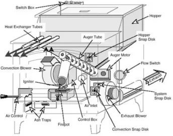

I know these stoves aren't he quietest out there but I just want to make sure I'm hearing what everyone else hears. What noises if any should come from the bottom auger/auger motor? My stove seems to have a constant scratchy noise coming from the auger motor. I can't remember if I heard it last year or not and I am driving myself nuts trying to figure it out. I have been scraping the carbon buildup from the auger tube and I don't hear any binding or squealing. It's just an annoying faint scratchy noise.
You could use the diagnostics test to operate only one fan or auger at a time, and at least narrow it down.
If done with a cold stove with an empty hopper, you can just about dive in there an see what's going on.

Here is some food for thought from all my research. :)
Note: Englander Stoves do not have snap discs.
See handy noise chart in Link Below! Also download the PDF below!
From
(broken link removed to http://www.eastcoasthearth.com/blogs/pellet-stove-parts-101/14706053-normal-pellet-stove-operating-sounds-vs-sounds-that-indicate-faulty-components)
Pellet Stoves Normal Operating Sounds VS Sounds That Indicate A Faulty Component​
Click pics to enlarge:
