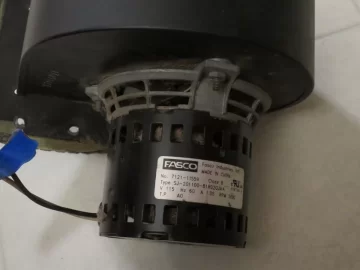

The room air blower hadn't worked since I bought it, so I removed it and saw that the squirrel cage was packed completely full. Cleaned it out, plugged it into the wires for the combustion blower, turned on the stove and it blow strong. However, both this motor and the identical combustion blower motor make a fair amount of bearing noise. The motors don't appear to have oil ports best I can tell. Are these serviceable or would I need to replace completely? If they do need to be replaced are there any good low cost replacements? It'd be nice to cut the noise and have piece of mind that the bearings won't fail, but considering its in a wood shop the reduced noise isn't worth the $200+ it'd cost to replace the two motors.

as far as the motors. once the bearing is shot oil wont help. You could if you had a lot of time and patience remove the old bearings and press on new ones. i wouldnt bother. The motors last a long time when you keep the fans clean. My pdvc is from 2006 and still using the original combustion and room air blowers. i should note my stove runs full time during the winter, only being shut off for 30 minutes each weekend for a cleaning.
as long as no metal is warped or split on the stove from not having a room air blower, the investment in new motors is worth it.
