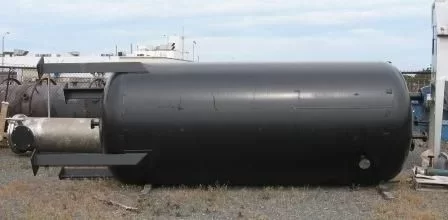

Here is a pic of tank, negotiations are in progress.
Wow, that is a big sucker! How long will your boiler have to run to heat that thing up to a useable temperature? 2800 gallons may be bordering on overkill. You might want to try filling it half way up and pressurizing it with air or nitrogen to see how it does. You wouldn't need an expansion tank at all if you did it that way.

I am indeed considering pressurizing it with N2 to eliminate the need for add on expansion tanks. A lot of decisions still need to be made, but location will be less than 20' from my boiler as I will bury it next to my house, adjacent to my basement boiler room. This process is going to take some time, but I will post pictures as the project advances.
