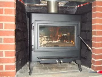

Howdy,
It is 65 degrees here in Chicago and all the windows are open as I burn the 2nd fire in the Englander 13. This is a "break-in" fire and lots of smoke is coming off of the top of the stove. Not a "burning wood" smell, but a "paint-curing" smell. Really stinks something fierce.
As I am new to this, just wanted to ask is this normal?
Great way to check all 11 smoke detectors in my house (1 hasn't gone off yet- hmmmm?).
On the plus side, when I can get the nerve to stop staring at the stove (again, I am new to this and don't want to leave the fire alone) I text my across the street neighbors and they give me updates on any smoke coming out of the rain cap. No smoke! I guess I am burning the 2.5 year old black locust wood efficiently.
On another "plus side", it will be down to 29 degrees here for Monday to Wednesday- so I want to get ready for a real fire....thank goodness the windows are open today. I feel like a dog- just sitting in front of the fire and staring at it. This Englander 13 is easy to operate and beautiful to look at.
Man, I love this Hearth.com forum.....I see now that many of you were not kidding when you say "Welcome to the madness".....this is madness! And I want to be committed.

Since there is no smoke coming out the chimney all of it must be going into your house!!!
Joking..sounds like all is good. You could put a fan in a window near the stove blowing out though,should help.
Ha ha ha....Jumped out of my chair there....
Thank you for the fan suggestion...it cleared up the room in a minute!
some smoke more than others -probably due to date of manufacture. My 30 was relatively light on the burn in smoke and paint smell but my guess is it may have been on the shelf longer(so to speak) No worries - fire it up and let er' eat! Your not going to hurt that steel box. Enjoy the heat!
The smoke could be from having a poor draft being it is 65 degrees outside....
That was my first thought too - but if it doesn't smell like wood smoke then probably not.
I can't imaging firing up with it 65 outside - my draft would REALLY be bad.
On the bright side for OP - if you are able to get it to burn well at 65* outside, you certainly can expect you will not have insufficient draft issues, just wonder if you will have too much draft when it gets really cold....

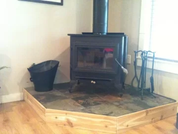

I built my 3rd fire a few days ago
my englander 13 too! Like you I had a good bit of smoke in the house from the paint curing the first two fires. That third fire it was much less. I also have about 14' of pipe and have had no problems at all. Been burning since December with a 17vl. I decided the 13 would be better for my drafty old house and I wanted better burn times. It's supposed to be below freezing here tomorrow night so I'm hoping to turn her loose! Probably be my last for the year. Good luck fellow 13 owner!
