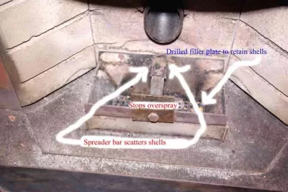

Did u modify your Burn pot to do the nut thing?
Yes, two changes to the pot on the Advantage 2T
I added a stainless filler plate with rows of small air holes to kep the shells from falling through the grate
Added a little steel bar in the pot that aligns with the center of the drop tube.
The bar scatters the shell pieces over the fire, otherwise the stuff just falls into a pile in the middle of the pot and builds up a little CONE.
Over a few hours the pile of shells will just char and continue to gather in size.
The "scatter bar" works fairly well to Help eliminate the issue.
Not perfect but quite workable.
(Two Piccys posted)
Since this piccy was taken I have replaced the little small square plate that the bar is bolted to, with a piece that goes the full width of the fire tray to stop shells from flying out into the surrounding part of the firebox.
During cleaning I found that there was more shells laying unburned in the front of the firebox than was acceptable.
Now with the new piece bolted in, this is eliminated.
The shells slide down the chute, hit the bar and scatter over the pot area. With the lengthened front "Backstop" at times the material hits the plate, then falls back onto the fire.
Usually the Advantage can go all day without my having to stir the pot.
I keep the airflow cranked up a bit (draft rod pulled out about 1/2" from the stop)
I can only make this adjustment after the fire has burned for a hour or so and has established a good bed of coals.
A fresh clean fire pot will burn almost all the shell material between feed cycles on the low setting if I give it too much air right off.
After the hour run time, there is enough coals though to keep the fire active.
I only run the stove on the LOW setting with shells.
This is a 2 second feed and a 7 second burn cycle.
Number 2 setting is 2 on and 5 off and will build more fire than I want for long term burning.
The stove runs hot enough that even on low the stack stays plenty hot so as to not accumulate burnable condensate in the outer end of the pipe.

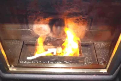

The little Prodigy is slightly different.
The burn pot is built a tad different and required a slightly different scatter bar to do the job.
A similar idea, but different shape is all.
The first Piccy is the Advantage 2T
The second Piccy is the Prodigy under fire
Snowy

Took a while to get it all sorted out, but it works pretty well.
