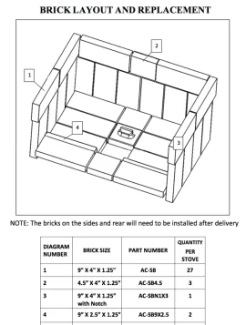

Looks to be about a 21" x 16" firebox based on the manual's firebrick layout.
[Hearth.com] 30-NC
