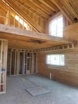

I am going to be installing a stove pipe chimney in the house I'm building but not sure on some of the details. The chimney will be 8" and be a straight shot through 3 levels (2 floor systems and a cathedral ceiling). The pipe length inside the structure will be about 29' total. Will be burning pine in a Vermont Defiant. The pipe will not be inside a chase.
Do I need double wall or is single wall going to work just as well? Not sure on the pros/cons of each. Price for DW seems to be the big con. Not being a hazard to touch seems to be the pro for DW. Let me know if there is more to it than that. (I'm leaning against doing a full masonry chimney, but feel free to make a case for doing so instead of stove pipe.)
What sort of hardware do I need between floors and in the roof? I have excessive clearances built into the joist systems where the chimney will pass through, and will frame those in to fit whatever the required hardware is between floors.
