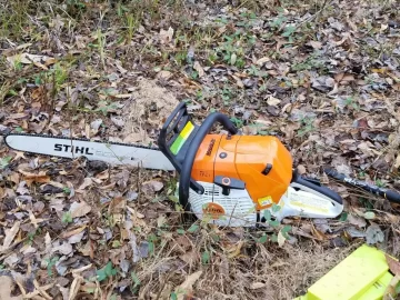

Saw .. we want the saw in the next pics!::-)
[Hearth.com] 441cm or 461 Nice!!!!
~nice
