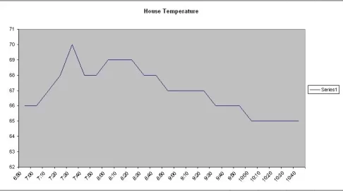

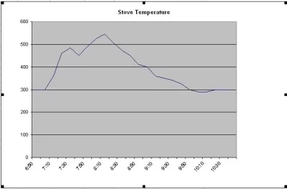

OK, so now that I have a little more experience, I did a burn and collected data every 10 minutes. I did fiddle with the controls a bit, but this is about the best I can do. I am curious if the collective opinion is that this was a bad, decent (average), or good burn. It's about the best I have gotten so far, with my suspect wood. That is, just under 4 hrs useful burn. Still very far from getting a useful overnight, when I cannot fiddle as much as I did here, opening and closing the air control.
Attached some graphs also.
3 oak splits, 3 cherry splits. Total weight, 32 lbs. Loaded E-W, 2 in back, 2 in middle, one in front until 7:30
Started at 300F, after burning down most coals in front then spreading around before reloading
Outside Temp @ 6:50: 15F, Wind 10 mph, feels like 5F.
Outside Temp @10:30: 12F, Wind 10 mph, feels like 0F.
Stove Thermometer measures 415F in a 350F oven. I think stove top is ~150F hotter than where the thermometer
is, so thermometer should be measuring 85F less than actual top temps, since it is on the front of the insert.

Not bad with a blower running, especially if the wood is not fully seasoned. The tighter you can pack the firebox, the less airspace and longer the burn. One exception noted, the wood orientation. By the description, it sounds like the stove is being loaded E/W, not N/S. Try a full load, rotated 90°, butt ends of the wood facing the glass (S). That may allow the air to be closed further during peak burn.
Correct, the load was E-W not N-S.
You probably know that adding a log on the way up to peak temp is less than ideal--even though its fuel, its cold and soaks up a lot of heat while the other logs are now heated to a proper temp for proper combustion. The air influx while the door open also cools the the flue and sets your draft back (at a constant air setting, why you had to reopen). As BG said, better to load full up at the beginning, and find the split size/ load orientation/ packing density that allows a rapid (i.e. less smoky) takeoff to a happy cruising temp.

The temperature trajectory you posted is about what I usually see. But my temperatures are usually about 100 degrees higher at each point along the way. As I understand your post it sounds like you think the actual temps might be higher than what you recorded so that makes sense.
Your 12F is much colder than our usual 35-45F but I suprised your house temp. isn't quite a bit higher. Ours woud be in the mid-upper 70s after a burn like that.
Had you been burning for while before your test load? Or was this the first load after a kindling startup?
Your 32 lbs. of wood probably amounted to something like 150,000 BTU (assuming 5,000 BTU per pound which might be low). Maybe it's still pretty wet which is taking up lots of heat?
PNWBurner said:
Your 12F is much colder than our usual 35-45F but I'm surprised your house temp. isn't quite a bit higher. Ours would be in the mid-upper 70s after a burn like that.
I had been burning all day. I have 2600 sq ft., with large old inefficient windows, and poorly insulated attic. It's pretty bad. I am surprised its as high as it is. 66F-67F with wood heat is a lot more comfortable than the same with natural gas heat. If I keep the blower on high, it will get to 72F-74F, for a short time, but the insert cools off much more quickly.
