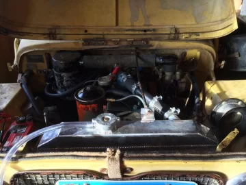

Ever wonder why many keeps overheat?
R is NOS bellow thermostat L is new new modified with 2 1/8" holes
NOS entire cap lifts modern only center opens [Hearth.com] 48 CJ2A oil?[Hearth.com] 48 CJ2A oil?[Hearth.com] 48 CJ2A oil?[Hearth.com] 48 CJ2A oil?
