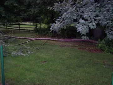

The side yard is no where near a neighbor, the back yard is about 25 feet from the property line. I don't mind if it is visible, which it will be in either location. This photo shows the side yard location, the shed would go roughly in the area of dirt just past the grass. The main problem with the side yard is that I would have to bring about 8 cords of wood over there annually, and it is about 100 yards from where I process. I have the tools to do so (tractor, trailer, pickup) but that involves driving over the only "lawn" on my property.

I should add that the above photo is taken from the door in the room where the stove is. Its a photo of a tree that had just fallen, literally a day after I told my wife during dinner, "I don't like the way that tree leans towards the house, I'm gonna cut it down." The next day it falls over during a storm.
