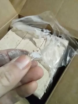

Recently I ordered some bricks from https://www.ecoheatfirelogs.com/
They claim 100% hardwood sawdust, no additives on their website.

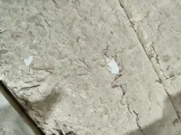

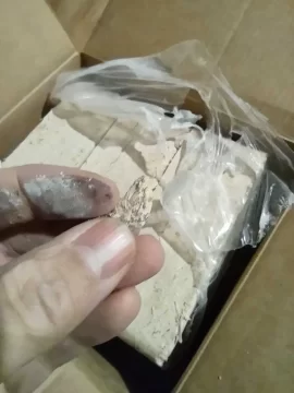

I open my box and find white melamine pieces pressed into the bricks. And a green piece, i.e. some paint or stain.
So their feedstock is not just sawdust but is contaminated with crap (particleboard etc.)
I'm asking for a full refund as I don't want to run stuff thru my cat that is not wood - will see what they say. Will update when I know how they respond.
Given their apparent lack of feedstock quality control, I would advise every cat stove owner to avoid ecoheatfirelogs .
If they respond reasonably, I'll note that here too.

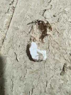

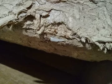

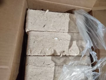

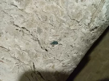

Pics: (in the order I see them here)
- 3 bricks in a box (and another 3 the layer below). White piece visible.
- Zoom in on white piece (and a smaller one to the left.
- Dug the white piece out, top
- and bottom. Looks like melamine particle board. That's plastic on top and glue in it.
- Another white piece at the edge of a brick.
- A green piece, seems like some stained wood.
- White piece next to the hole it came out of.

The bricks are said to be composed of "a bi-product of the furniture, flooring and woodworking industry. " Looks like some floor-sweepings got in there too.
BKVP has warned against burning some compressed fuels in a cat stove due to contamination. Waiting for a summary of BK testing. So far I do know that Northern Idaho Energy Logs pass muster, but they are not widely sold.

Well, for all those reading this, I did get a response.
"Sorry to hear about this. We have sold tens of thousands of these six packs and have only had two complaints, yours being one of them. We work very hard to make sure that it is just our sawdust from the flooring mill but somehow, something has gotten into that batch evidently. We will process a refund. Please dispose of the product."
Mistakes can happen, but they owned up to them without pushing back. (And they gave a refund.)
How one deals with mistakes or things going wrong (in my view) is telling. And the way they handled this is good for me.
