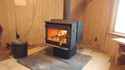

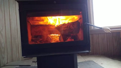

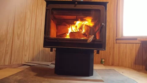

what i really like about the stove after using a normal stove forever is the ability to control the fire and regulate the temps, and it holds its heat forever. It gives you alot for the little money it is. it heavy and tough, i like the height its easy to load. you can fit pretty big wood in it. 2ft or so probably width, when i pack it across the back and smaller front to back. the time it lasts really depends on the wood, its not like the old stoves, i pack it at night and after it burns down the bricks/ash/and metal hold the heat so its got red ashes the next day
A couple minor gripes would be the fan is pretty loud, and the ash gets on it every time i try to clean it, but its understandable they try to make the window as big as they can.
It had the flat seal issue at first till i kneaded it, then has worked fine, it has been used almost every day since i got it, has been great.

Based on the side view it looks like it would be fairly easy to open up the top of the rear shield and attach a short convection hood so that the fan blew over the top.
The fan base is bolt to the rear shield but doesn't pick any heat from the stove or blow between the shield and the back wall of the stove. It just sits there moving ambient air behind the stove. It doesn't direct air at all.
i heats plenty on its own, the top is the hottest spot obviously but i normally dont even run the fan. i have a ceiling fan over it use and i made it the lowest point in the house, idea being we have alot of power failures and i wanted something that i could still get heat from in our living room and bedrooms up stairs. the living room is two rooms away but open and and gets plenty warm and so does upstairs because of where i put it, the air can go up theres nothing impeding the air flow on the ceiling.
