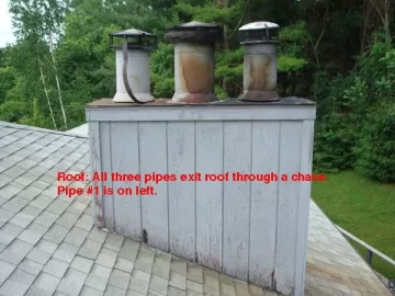

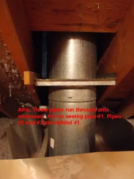

I will be replacing a factory-built chimney in a one-story ranch. The existing chimneys are held in place by combustibles (plywood at the top of the chase, sheetrock going from first floor to attic), so I can't just replace what's there. I need to know what the right way is. The new chimney will begin at the ceiling in the basement, go through the first floor in a dedicated chase, go through the attic unchased, and into a chase from the roof to air. I know that the chimney will be supported and anchored in place at the bottom by the chimney support going through the basement ceiling to the first floor. The chimney *might* be held in place laterally by brackets going up. I'm guessing it's held in place going from first floor to attic by the attic insulation shield.
What I can't figure out is what actually holds the chimney in place at the very top, right before the chimney goes through the chimney chase cover. As far as I can tell, the chimney chase cover itself must leave a standoff to the chimney, so it's not actually touching the chimney. Maybe I'm wrong. It would make sense to me that the chimney chase cover would also hold the chimney in place, but I think I read that the holes in the chimney chase cover must be 2" bigger than the chimney outside dimension.
Hope this question makes sense.
Ken Benson

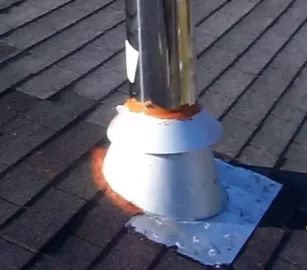

The class A chimney is vertically supported totally by the ceiling support box - at the first ceiling penetration (basement ceiling for you). Check how many feet of class A your CSB will support. The attic insulation shield and roof flashing/storm collar provide some horizontal support. More than 5 ft (I think) of chimney above roof decking requires a roof brace. So, if I was gonna chase mine - I'd have 2" chimney clearance of the chase top - just below the rain cap. Eg: 12" chase top hole for 8" OD chimney. The chase would be all cosmetic.

So assume chimney stands 6' above rooftop. If it was unchased, it would have a 2-legged brace. But it's inside a chase, and no part of the chase actually touches the chimney because of the 2" clearance all around the chimney.
What braces it? It has to be braced somehow.
One of my chimneys will stand about 6' above rooftop, the other about 7'. Existing chimneys are braced between rafters (at least, that's the way they're done now; if there's a more correct way I would change the one I'm leaving). Existing chimneys are further braced by the plywood and shingle chimney chase cover that touches them. I will fix this, by replacing the chase cover with a stainless cover, but this will remove the lateral support that the (illegal and dangerous) plywood is providing now.
We've been using the oil burner chimney with this setup since we bought the house in October, but I'm adding a wood boiler and I don't feel safe the way it is.
Ken Benson
