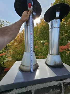

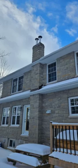

I have my Woodstove in the basement, with the chimney (6" rigid liner) going through an external brick chase. Also in the same chase is the 5" chimney for the hot water tank.
What's happening is, depending on the wind direction (seemingly) the smoke is coming out the stove chimney and then some is getting sucked back down the water tank chimney and going into the utility/furnace room.

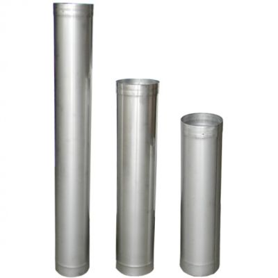

2. Do we recognize this brand of stainless steel liner?
[Hearth.com] Backdraft through Hot Water Chimney
It uses twist-lock to connect the male/female ends. The only markings I can find on it read "Made in Canada" and "000000"
Most options up in here Canada are Selkirk, DuraVent and ICC, but google image doesn't seem to show a good match.

OK, if it passed inspection then it's likely in a full masonry chimney as a rigid liner. I'm not sure who makes it, but the brand is less important with single-wall if adding an extension as long as the diameter is the same. Maybe ICC?

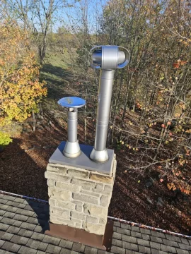

I've added the extension and Vacu-Stack cap to the woodstove.
Although it feels fairly solid and is still under 5' from the stone work, I may get a brace for it regardless.
If there's still any smoke backdrafting down the lower hot water tank chimney I may grab a directional wind cap for it as well, but I'm hoping this makes the difference. I'll give an update either way in case any others have a similar issue.
View attachment 340677I
It looks good. I hope it solves your problem, and thanks for the update!
