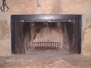

Here are the pix I promised.

Is that an old Heatilator T4800? Maybe to small for that though. Looks like one of the old T series.

Its a Superior Fireplace Co. Builders 836. Haven't been able to find anything on line about it; just have the Builder Installation Instructions.
