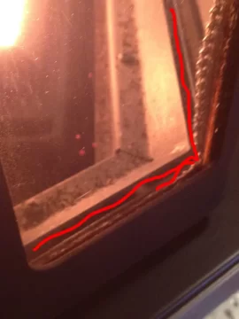

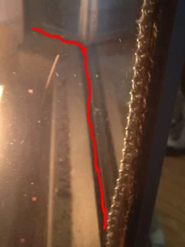

So I checked that front lip this morning during my daily cleaning and wow is all I can say. Totally plugged with ash and ive only had the stove 2 months. What a dumb design. Anyway I used a small boiler brush I had laying around from my hvac days and it was still a fight but I believe I got most of it. Kinda makes me wonder whats flying around the right and left side of the exchanger tubes where theres no access at all to clean back there. Now this airwash thing is new tom me can somebody post a picture of this airwash thing and plugging it with gasket. I see nothing of the sort on my 5660
Airwash vent lower edge of the door when the stove door is closed.

Good to know. Ill keep this I mind next time I pull the rear walls for cleaning. And thanks for the photo. Ill play around with that airwash.

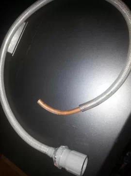

I decided to fabricate something quick to get in there and suck up all that ash instead of fighting it with a little paint brush or boiler brush. I scratched up the fake brick panels some so i needed some other way to approach this. A little bit of 3/8 fuel oil line bent to get back there and reach the pockets. Works like a charm
